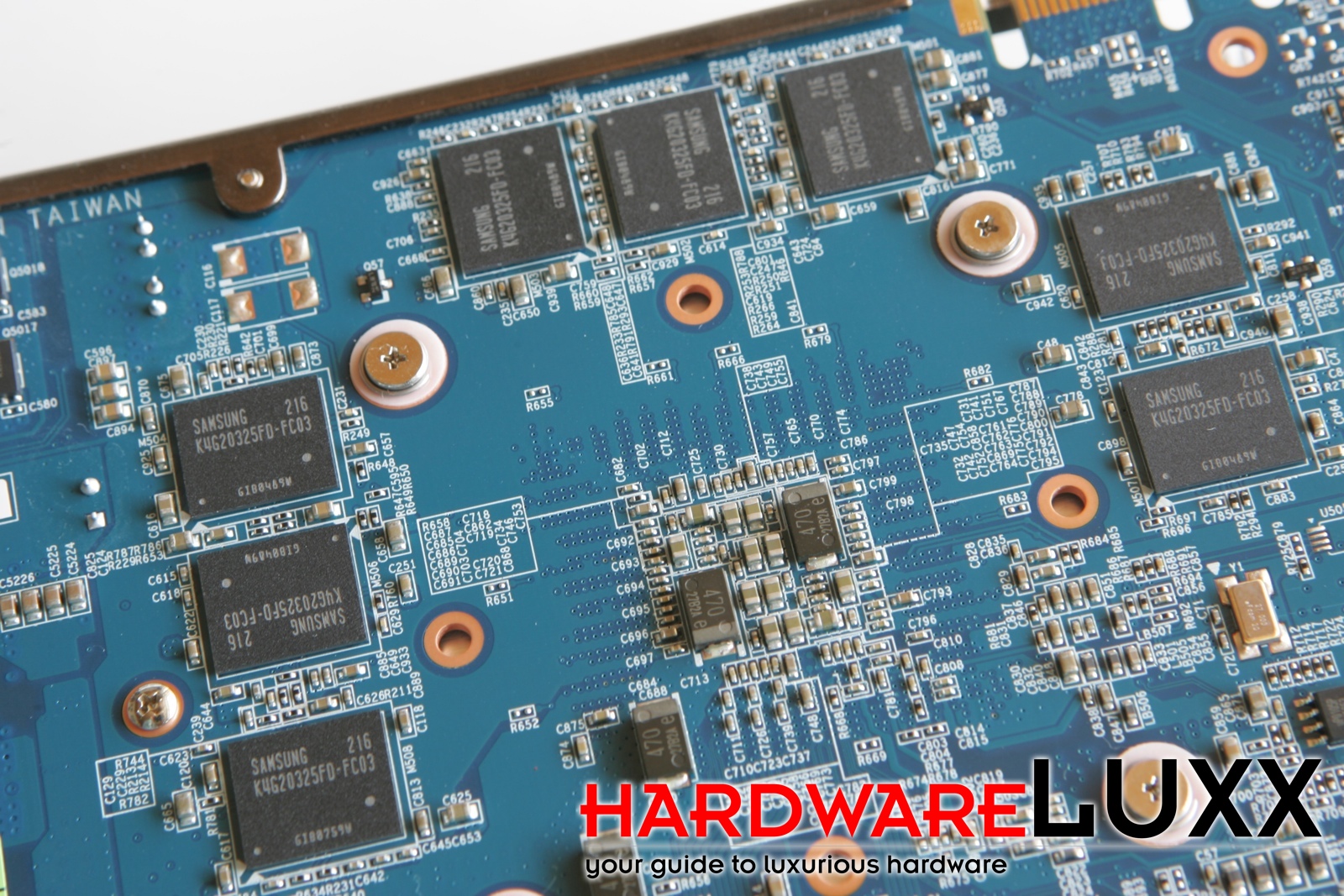

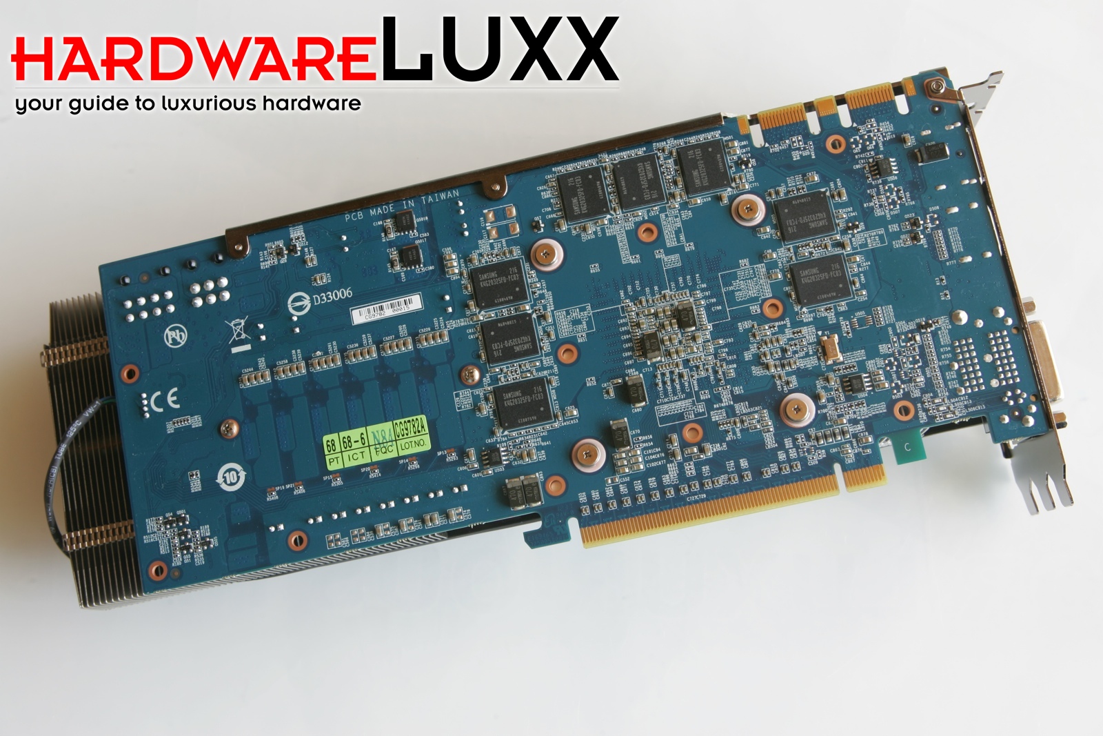

Hi, everybody! Thanks for an interesting topic.
To me it is most interesting "mod GTX 680" to quadro k5000. Now I have no any graphics card based on the chipset gk104. Therefore, I am
free in its choice. The most promising option I see GTX 680 + 4GB mem. For K5000 is important to have the largest possible volume of onboard memory.
With only one such card was a successful experience modding. EVGA 04G-P4-3687-KR GeForce 4GB GTX 680 mod to K5000. Unfortunately, reefjunkie did not
described  the details of this mod. It is possible, P?B was the same as with GV-N680OC-2GD
I consider following variants of devices:
Gigabyte GV-N680OC-4GD
photo#1reverse side
photo#2 reverse side
photo#3 reverse side
photo#4 reverse side
photo front side
Unlike the GV-N680OC-2GD, Y1 repositioned to the rear side. Different connectors resistors. Independently I do not find their location.
ZOTAC GTX 680 4GB [ZT-60103-10P]
back side
front side
Video card similar to GV-N680OC-2GD. It is possible, it would be similar mod. The board kept the reference design. It is strange that nobody had chose it for the experiment.
EVGA GeForce GTX 680 FTW+ 4GB [04G-P4-3687-KR]
Pictures with a PCB-s I have not found. Mod executed by reefjunkie described here However, no description or photos of the device before and after mods. If it is possible, reefjunkie , please give more details.

Looking at the new gtx 650 Ti Boost, it looks to be almost identical to the Quadro K4000 short the memory (same processor and cuda core count.) Would it be a hardware only or a require bios or softstrap mod as well to be done properly?
It is impossible to say until someone get bios from card.
ROM BIOS for K4000 is available here http://www.techpowerup.com/vgabios/130511/NVIDIA.QuadroK4000.3072.120813.rom

There's also PNY GTX 680 4GB - I have one: http://www.amazon.com/PNY-GeForce-Graphics-Cards-VCGGTX6804XPB/dp/B009MQTVTE which basically appears identical to EVGA one.
Not yet modded to K5000, thinking to put a dip switch so I can go between GTX 680 and K5000... :)
Offline amigo
  • Posts: 108
  • Professional Wannabe
Re: Hacking NVidia Cards into their Professional Counterparts
« Reply #279 on: April 13, 2013, 01:44:30 pm »
To me it is most interesting "mod GTX 680" to quadro k5000. Now I have no any graphics card based on the chipset gk104. Therefore, I am free in its choice. The most promising option I see GTX 680 + 4GB mem. For K5000 is important to have the largest possible volume of onboard memory.
With only one such card was a successful experience modding. EVGA 04G-P4-3687-KR GeForce 4GB GTX 680 mod to K5000. Unfortunately, reefjunkie did not described  the details of this mod. It is possible, P?B was the same as with GV-N680OC-2GD
Gigabyte board is not a reference, they have redesigned it (look it has 6+8 pin power connector).
Zotac has a board with 6+6 as well as EVGA and PNY (which I believe are identical).
I would probably go with EVGA or PNY (I have the later).
I believe that moving resistors around might only be half the process to get the true high-end features (SpecViewPref).
The system *will* detect the new hardware but it is possible that the ROM BIOS also plays a role in configuration it presents to the NV system driver. Thus ROM needs to be modded/flashed, or alternatively NV system driver hacked. Who's up for it? :)
Here is one (taken from http://www.evga.com/forums/tm.aspx?m=1664376&mpage=1)
http://i18.photobucket.com/albums/b147/ArcticSilver/EVGA%20GTX%20680%20FTW%204Gb%20with%20Accelero%20Twin%20Turbo%20II/IMAG0212.jpg
It's identical to the 2GB one and I think this is the reason reefjunkie didn't elaborate on what was done.
Thank you! Now I see.
Zotac - yes (6+6), but  EVGA has 8+6 Power Design. There is also a variety of cards 680-series, made ??by EVGA. How to find out which of them is identical to the reference? In Russia sell two variants of 4Gb vers. EVGA GTX 680 04G-P4-3687-KR and EVGA GTX680 04G-P4-2686-KR.
PNY version I have excluded. It is not possible to buy somewhere near. Zotac vs EVGA?  Is the question. Why did not anyone binds to Zotac? On the other hand, 04G-P4-3687-KR has already tested in mod. Less risk, possible.
So...that's not possible to mod a Gigabyte GTX 680 4G to a K5000?
I have not said so. For me it is - a difficult task.
