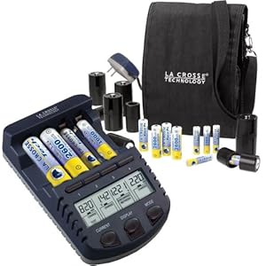

Don't know them at all but it seems they are mostly distributor and re-brander, and I presume they evaluate their products to meet German safety regulations.  So given this, I would presume the Uni-T DMM are treated similarly.  Here are samples of their product line other than the DMMs.
In the US, sold as the La Crosse charger
was the B&K Precision model line 1870/5, still sold as brands by RSR, Reed or Lutron
This one are truly an La Chinas .. big failure ...   ;D
I found it marketed under  6 brands , and the unfortunate part , is that it explodes ..
Thats why I become true fun of the latest Ansmann chargers, and battery stations & battery testers.  ( they do their own R&D and they do the manufacturing in China, but at list they use their own original ideas )
Voltcraft had build at the far past one Nimi 4 channel charger with for lines LCD - and processor running linux , able to charge - discharge - running maintenance cycles , with active coolers , with serial port ,
With extra supplied software , and the device had a cost as 200 Euros , and the cost of  PC software was extra .
Shape like a round spaceship ..  { True European technology but at a cost }
If the modern Voltcraft , has partners like the Uni-T , has nothing to fear at all .
They will gain lots of market share, and lots of cash ..
