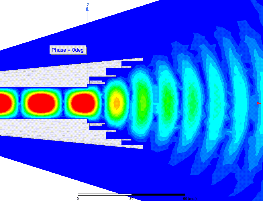

Let's start with an EM beam at very high frequency, such as a laser beam. Is the energy in the space occupied by the beam? I guess it is. Let's lower the frequency and consider an RF antenna beam: is the energy in the space? I guess it still is.
fig antenna beam animation in space
source: sudonull

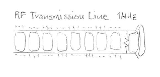

Lower it a little more and look at a transmission line feeding an antenna. I will add a resistor to steal some of the energy. Is there energy present in the space occupied by a beam exiting an antenna? If the answer to that question is yes, I would say that there must also be energy in the space between the conductors of the transmission line feeding the antenna.
fig animation from transmission line to free space
Now, keep lowering the frequency. The fields of a single 'cell' are basically following the same configuration, but the 'cells' gets longer and longer.
fig lowering the frequency
We will eventually get to a point where we no longer have appreciable radiation and the pattern gets stationary. Is the energy still in the space between wires as the frequency gets lower and lower?
fig transmission line from LF to DC - no radiation, just a fringe effect
When does the energy cease to be in the space between the conductors? At 1Hz? At 0.01 Hz? And at 0.00001 Hz? At DC (meaning from bigbang to bigcrunch)?
