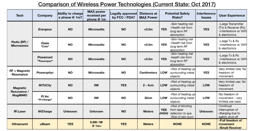

These claims in Oct 2017 turned out to be laughable, and even internally inconsistent.
You can't have "meters" (plural) range at max power, and also have max power at "0.6-1W @1m"
And you can't really charge a phone in any meaningful way with 0.6W-1W. Even a lousy standard USB port is 2.5W (5V x 0.5A), so uBeam could be almost 5 times worse than an already slow standard USB port.
And this is their own MAX claims!
No wonder they put their tail between their legs and pivoted to low power IoT, Meredith Perry's dream of charging a phone with Ultrasound failed miserably as everyone predicted. Once she was booted and the adult supervision came in the claims of charging a phone quickly faded into the ether.
