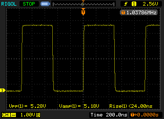

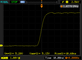

In lack of a precision waveform generator, I took some readings of a mega16 test circuit, which was battery powered in order to exclude any possible ground loop noise, since its ground is floating. I chose to read a simple waveform generated from a mega16 because these Atmel microcontrollers are notorious for their output stage drive capability, since their output stage is a true complementary one with Rds_ON=24Ω ±10% at Vcc=5.0V at room temperature.
Here are some readings from a mega16 running at Vcc=5.02V, programmed to generate a simple 1.038MHz, 50.0% duty cycle square wave, using its hardware PWM and clocked by its internal RC oscillator calibrated for optimum UART baud-rate.
Please, keep in mind that using the same exactly mega16 setup, my previous unit displayed a crisp square wave without the need of using the ground spring or any further filtering.
1: Ch1 x1 waveform using ground lead, unfiltered
2: Ch1 x10 waveform using ground lead, unfiltered
3: Ch1 x10 rising edge using ground lead, unfiltered
4: Ch1 x10 waveform using ground lead, filtered
5: Ch1 x10 rising edge using ground lead, filtered
6: Ch1 x10 waveform using ground spring, unfiltered
7: Ch1 x10 waveform using ground spring, filtered
Here is a couple of readings using a lower noise x100 probe (250MHz, 6.5pF).
Please, note that the x100 probe is properly compensated, using the 1.0KHz probe compensator connector.
8: Ch1 x100 waveform using ground lead, unfiltered
9: Ch1 x100 waveform using ground lead, filtered
-George

Offline saturation
  • Posts: 4787
  • Doveryai, no proveryai
    • NIST
Re: Rigol DS1052E nasty surprise!
« Reply #11 on: June 14, 2011, 08:50:30 pm »
Those are ouchy photos, Hellene! Seems like you can rule out its the probe.
Can you run your noise sample test as you did with the post quoted below on Channel 2, alone? Channel 2 looks quiet and fine based on early images you've posted, see image.
Given its potentially good performance its suggesting the issue isn't with the ADC or a major PCB issue.
Also, the noise with no input, that is reading just its internal noise seems fairly close to mine.

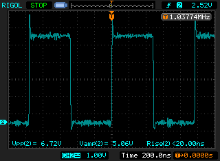

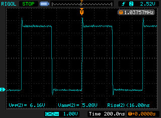

Offline A HelleneTopic starter
  • Posts: 602
  • Country: gr
« Reply #13 on: June 14, 2011, 11:13:57 pm »
Well, it seems that the Channel 2 test results are a carbon copy of the Channel 1 ones, above!
So, the analog front-end alone must not be held responsible for the noise issue.
Check: Two down (PSU, Analog front-end), who-knows-how-many more to go!
Here are the Channel 2 test results:
1. Ch2 x1 waveform using ground lead, unfiltered
2. Ch2 x10 waveform using ground lead, unfiltered
3. Ch2 x10 rising edge using ground lead, unfiltered
4. Ch2 x10 waveform using ground lead, filtered
5. Ch2 x10 rising edge using ground lead, filtered
6. Ch2 x10 waveform using ground spring, unfiltered
7. Ch2 x10 waveform using ground spring, filtered
Changing the probe:
8. Ch2 x100 waveform using ground lead, unfiltered
9. Ch2 x100 waveform using ground lead, filtered
Something different, now:
10. Ch1 probe on the probe calibration ground; 1GSa/s. Similar to "Noise 8" at the first message but in dot mode.
All the individual ADC samples are in the most expected positions.
Note that this is a full 1GSa/s because Ch2 is off as well as the long memory option; so, all the ten ADCs are involved and they all seem to be in order.
Three down... (!)
-George
« Last Edit: June 14, 2011, 11:34:22 pm by A Hellene »
