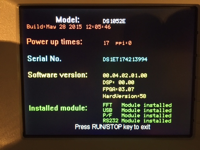

My scope system info was:
![](http://www.redhat.systems/scopeinfo.JPG)
You have to get into an "extended system info menu to see this information by selecting the "Utility Button", scroll down to "system info", select CH1 twice, CH2 twice, and MATH once.
