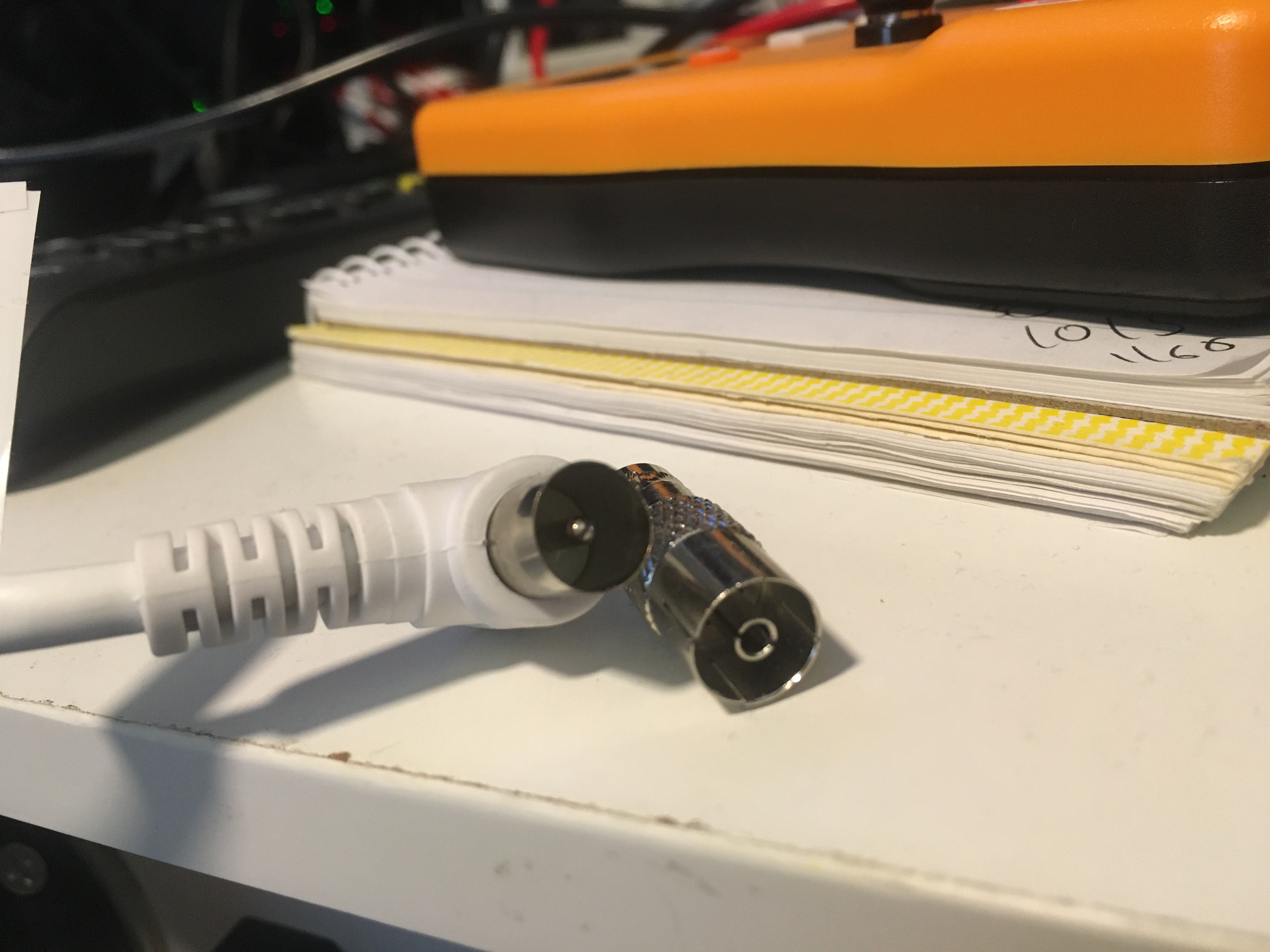

Can anyone tell me what the following standard connector is called? I've shown a photo of the male and female variants. This is just a standard home aerial cable. It doesn't appear to be F-Type, BNC, SMA, N-Type... so, what is it?

In Australia they are also called PAL connectors e.g.:
    https://www.4cabling.com.au/tv-antenna-cable-adapter-f-type-female-to-pal-female-adaptor-straight.html
    https://bitek.com.au/products/connectors-adaptors/pal-connector/

Sadly, in Oz, TV sets are delivered with an antenna input consisting of a female Belling-Lee.
That should be the only place such a horror exists, as TV antenna cabling uses the much superior "F" connector.
https://en.wikipedia.org/wiki/F_connector
Use the compression type F connectors on all the fixed wiring, which will ultimately appear on your wall as a female "F".
The final flexible coax to your TV should have a male "F" type both ends, then fit an "F" female to "Belling Lee" male adaptor.
The "Belling Lee" end of the adaptor is a far better engineered connector than the original could be even in the wildest dreams of the B/L designers back in 1922.
The silly thing is that a much-improved version of the B/L original could have been designed at any time since 1922, but they stuck to the horrible original "through thick & thin".
Unfortunately the plastic so-called "PAL connectors" you can buy these days are even worse than the original!

Over here we call it IEC antenna connector. F connectors are primarily used for satellite TV/radio.

It is an IEC connector + number according to the construction type.
It is used for both 75 Ohms - TV and radio - only in the opposite design - for the TV there is a pin at the connection point on the outside and in the TV there is a socket, for the radio it is the opposite
EDIT: they can also be found in a metal pro version

It is still easier to standardise on compression type "F" connectors & just use "F" to "PAL" adaptors.
Jaycar do a nice space saving "L" shaped one.
