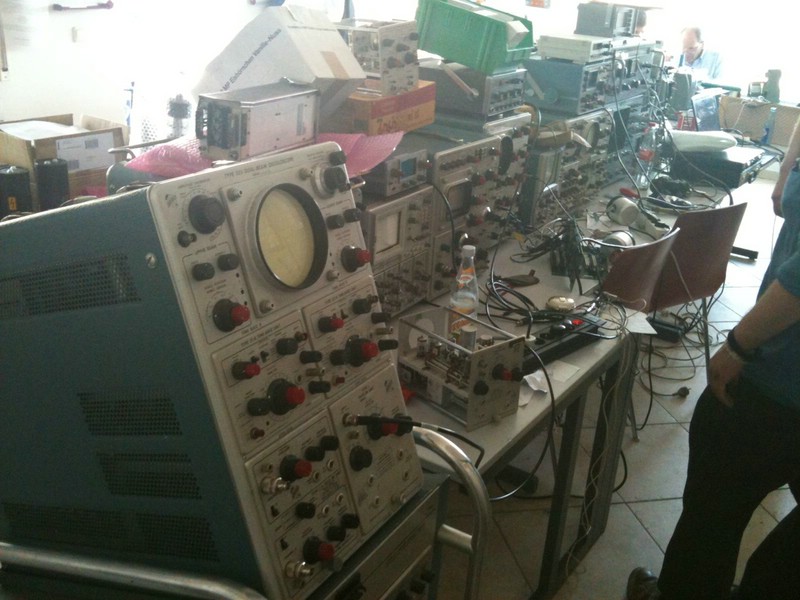

when you come to germany I will invide you to make a video "how to work with a classic Tek"
this was a meeting from one of the large antique radio forums here, I have build that glowing test place with parts of my collection. They are all in full working condition  :)
greetings
