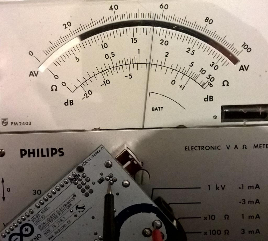

And to expres myself clearly I have made a measurement with a Philips PM2403 on an arduino board.
With the multimeter seted on x10Ω I receive a resistance value of about 570Ω.
I know the measurement it is made in DC but can I also say there is an impedance of 570Ω instead of resistance?
Thank you very much guys!
No, when measuring with dc you only know resistance.
Impedance is always related to frequency, and therefore that frequency should also be stated, i.e. 100 Ohm at 100Hz.
Or more common: a nominal or average impedance across a certain frequency range.

Impedance has two components, resistance and reactance. When energized with AC both resistance and reactance are present and impedance is the result. When energized with DC the reactance component disappears and only resistance remains. Under these circumstances impedance is identical to resistance.
Thank you very much Sir for the explanation.
So in my case with the multimeter can I say there is an 570 ohms impedance
or it is mandatory to use the resistance term every time?
Kind Regards!

« Reply #5 on: February 05, 2019, 09:17:31 pm »
As can be seen from the plot the impedance of the loudspeaker varies wildly with frequency, a typical
1/8 Watt metal film resistor would do much better in the audio spectrum and would produce a near flat line,
however at (much) higher frequency's it will also start to curve.
Yes, using the perfect resistor.  :)
In all other cases it is inaccurate to say that the dc resistance equals the ac impedance.
Your statement is true, but that is not what I said. What I said was that when measuring with DC then the impedance is identical to the resistance. In other words the DC "impedance" equals the DC resistance. This is true for all devices, perfect or otherwise.
Another way of saying it is that the impedance becomes equal to the DC resistance as the frequency tends to zero.

« Reply #7 on: February 05, 2019, 09:34:10 pm »
Kind Regards!
Not impedance, resistance would be correct but not always necessary to type.
For instance:
"The meter in the picture is reading 14 Ohms"
Or:
"The meter in the picture is reading 14 Ohms DC"
Or:
"The meter in the picture is reading a resistance of 14 Ohms"
I would count all of those as correct.  :)
