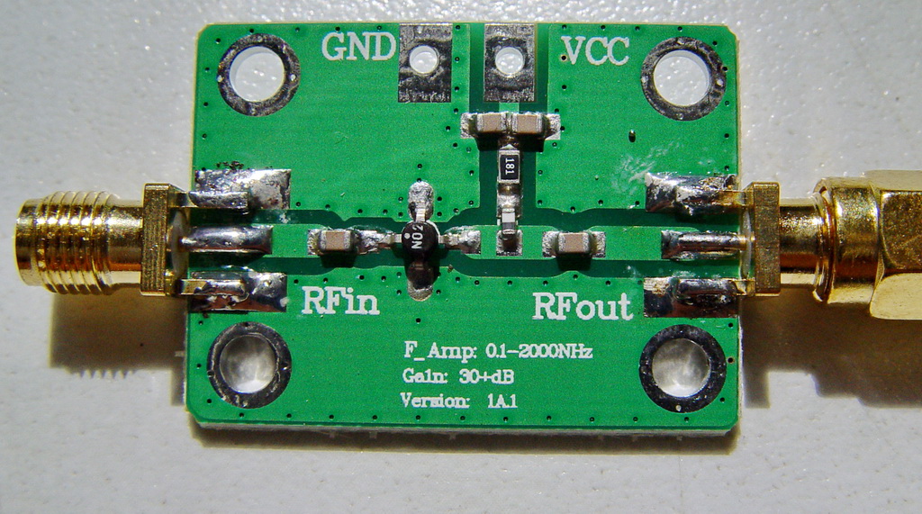

I would like to increase the range of my garage door remote.
I bought a 4 channel programmable remote, a 30db wide band RF booster and a 433Mhz antenna.
The problem is that I cannot find where the antenna is connected on the PCB of the remote.
It looks like that there is no PCB trace antenna as well.  Here is the PCB.  The back side is mirrored,
so that the traces are aligned.
and the amplifier :
Is there any point on the circuit above that an external antenna might be connected?
Thanks!

« Reply #1 on: September 20, 2019, 12:10:28 pm »
Try at the collector of Q1...
check datasheet of LR433T2
The circuit is designed to use the inductor as an antenna, but this worked perfectly, thanks!
Huge increase in signal power.  I can now make a compact unit that will reside permanently
in the car.
"Why not improve the signal to noise ratio by moving the receiver closer to wherever you want to operate it"
I will do that as well because the receiver module is behind the metal door.
Thanks!

Back to the notch filter idea then :)
>> Why are you talking about the FCC if you are in Greece
You know what I mean...  The corresponding European agency.  BEREC, CENELEC etc.
I actually didn't know, but OK.
Offline hggTopic starter
  • Posts: 970
  • Country: gr
Re: 433Mhz Garage Remote booster mod
« Reply #20 on: July 30, 2020, 05:59:37 pm »
The solution for me was to build a 433Mhz tuned receiving antenna with ground plane and place it high from the ground.
Now I can open the door from hundreds of meters way. Literally.
