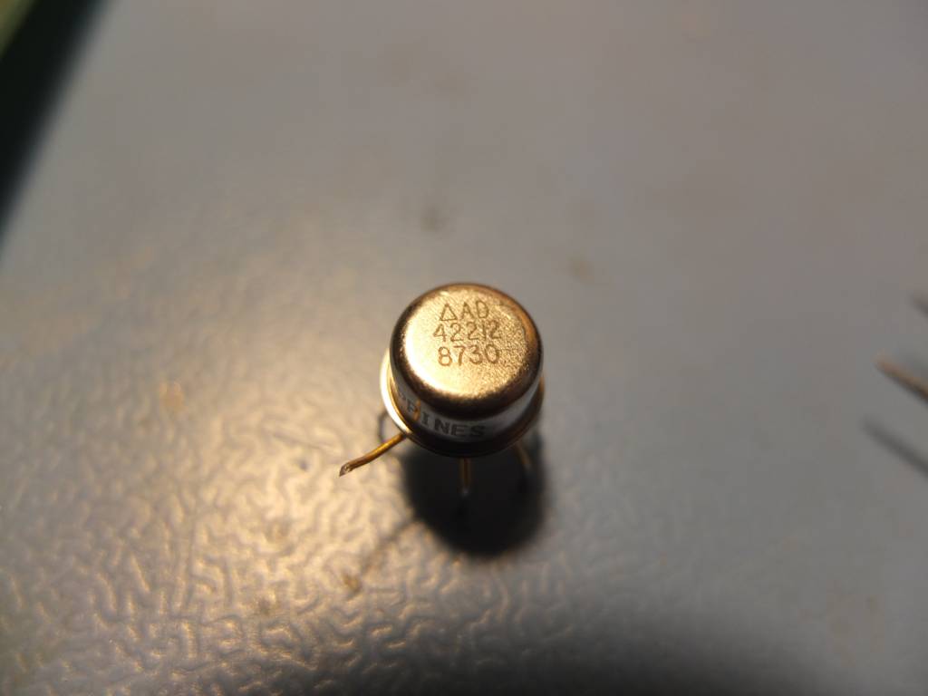

Today I've replaced the electrometer opamp. The result is much better though not quite as good as I've hoped for (if I deliberately run the K263 sandwiched between two hot K2015s, so the temperature on a side panel gets to 35C, the bias current is under 50fA, before it was about 200fA). When the unit has good ventilation the temperature on a side drops to ~28C and the current is steady 9-10fA. Perhaps the other bits in the circuit (relays etc) do add some leakage. I may look at it again in detail when I'll have time - possibly when I'll replace some electrolytic capacitors on the main board, as some are definitely not well as visible on the photos. The AD549L (according to the manual) opamp has a different number on it, most likely a specially selected for the lowest bias current. One definite benefit from using the ADA4530-1 is a much faster recovery of the bias current after overloads and various switching. With the old opamp it could take 10-20 minutes to get back to the minimum current, with the new one - usually under a minute.
Cheers

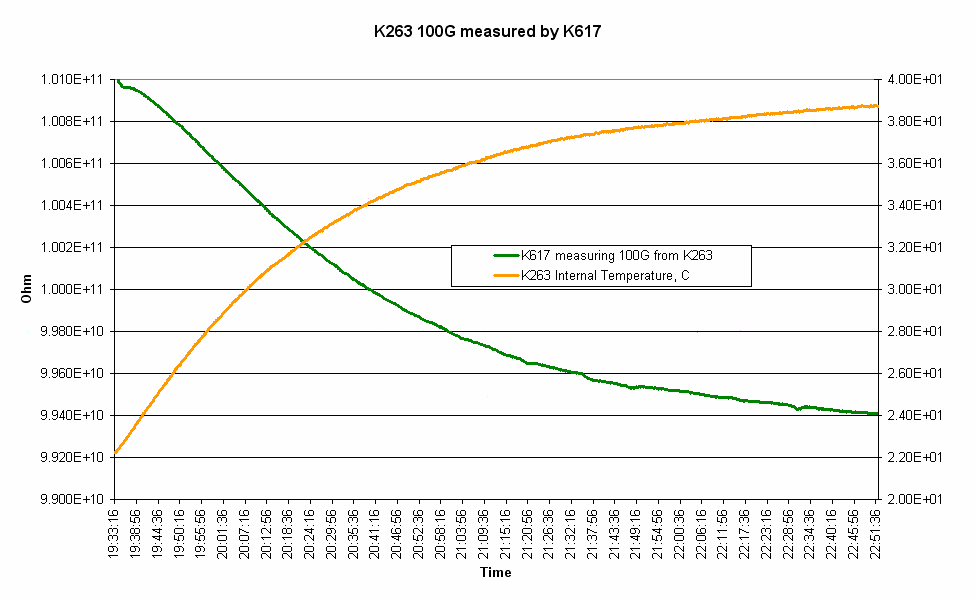

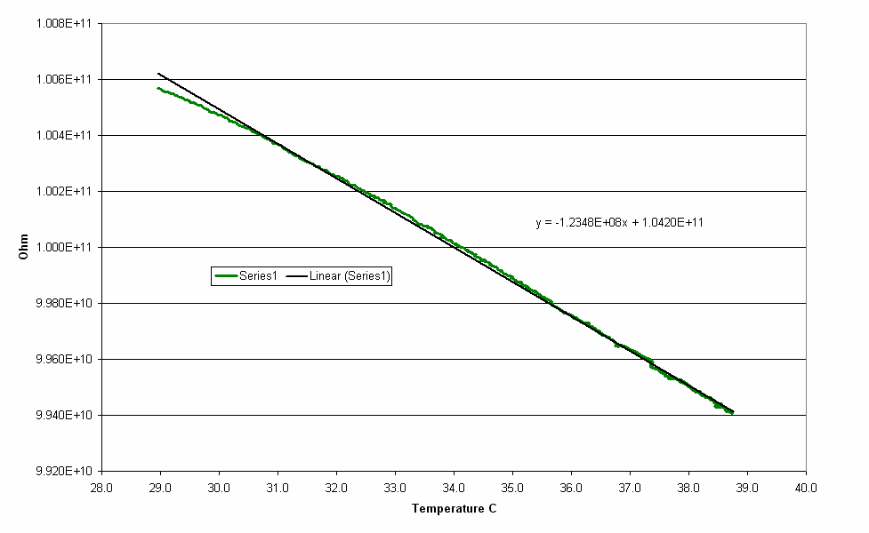

Today I've measured 100G resistance sourced by the Keithley 263 during a warmup from room temperature (22C), using the K617 (well warmed up). The result is somewhat disappointing - the tempco of the internal 100G resistor is over -1200ppm/C (between 29C and 39C) and the internal temperature correction is not compensating for it fully. I am planning now to upgrade the K263 with a hermetic Ohmite RX-1M 100G resistor which has about 6 times lower tempco. Below the results of the test.
Cheers

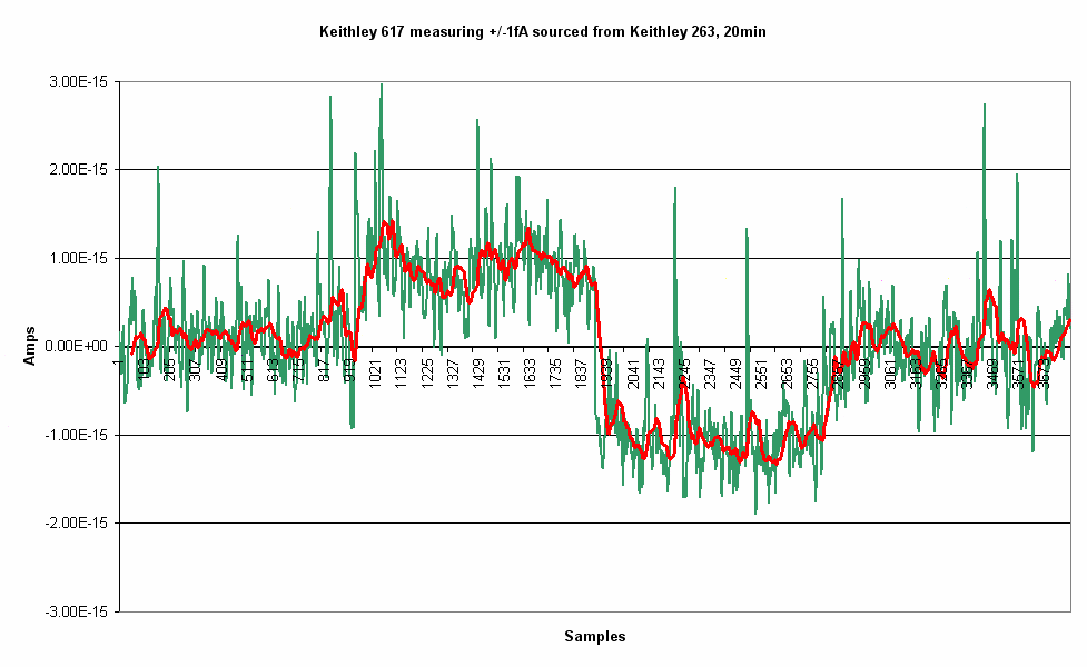

And here I'm trying to push the limits of detection. ~20min run, 5min idle, 5min +1fA, 5min -1fA and 5min idle, sourced by Keithley 263 and measured by Keithley 617. The red line is 50 samples running average, vertical scale 1fA/div.
Cheers

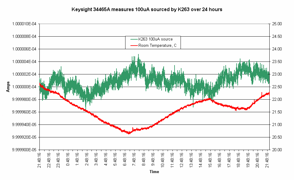

As the Keithley 263 is at my work lab at the moment, I've measured 1mA current sourced by it on two meters at the same time - Keysight 34465A and HP3458A. The results over two hours are on the graph attached. In general, the 263 is quite stable and accurate. Also nice to see both meters agree with each other down to few ppm.
Cheers

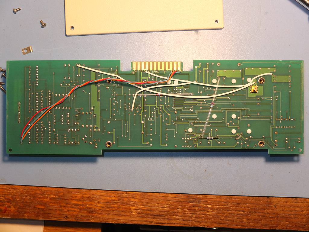

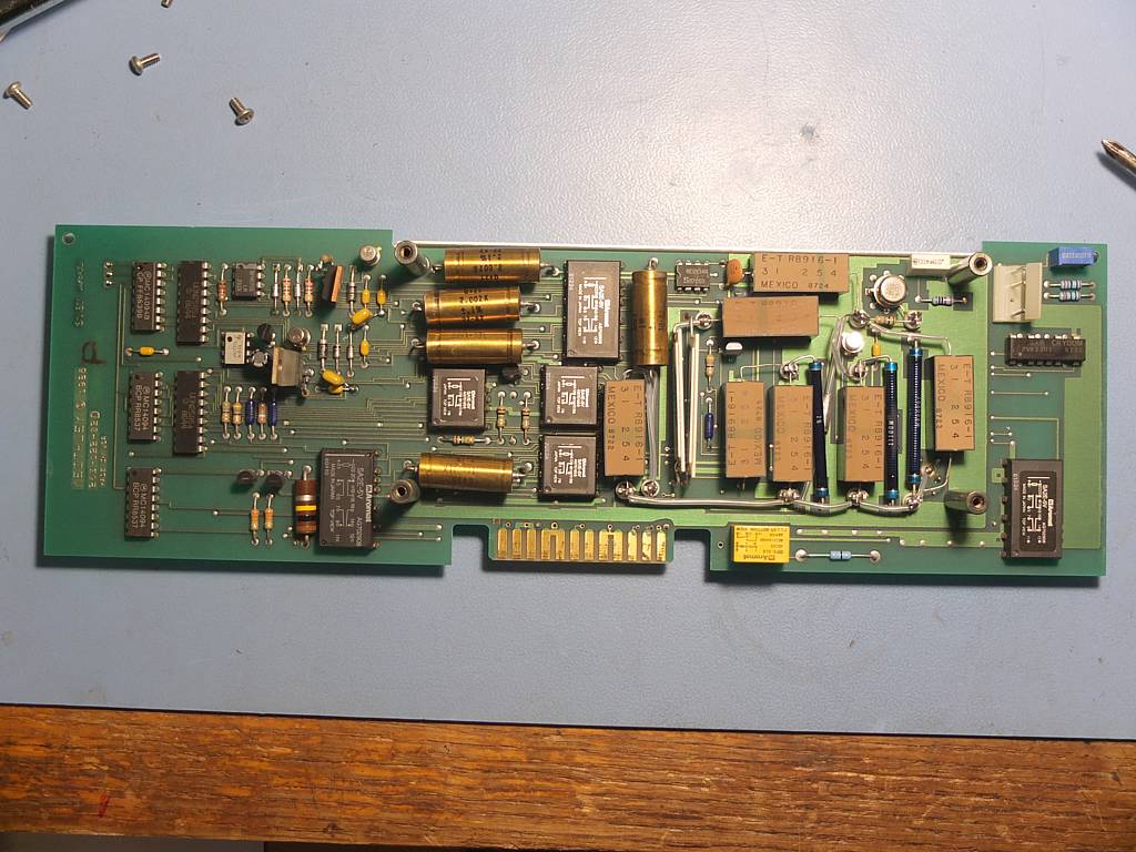

Hello all,
meanwhile I checked the analog board of the 263. and I found out, no relay is defect, but the 1M resistor R32 !? How could this happen?
I have build a temporarry replacement of the resitor with a set of metal film resistors and a poti.  I adjusted the resitance with my HP 34401 to exact 1Meg Ohm at room temperature.
anyway, I took a few photos:
1st:  K263 analg board
2nd: R32 on analog board, defect
3rd: schematic of my temporary replacement of R32
4th: setting 1µA output current at k263 (2µA range) and measure it with  K487 (borrowed from Philipp, friend of mine)
I'm going to order a 1M Resistor from Mouser:
https://www.mouser.de/ProductDetail/Caddock/USF370-100M-001-5ppm?qs=sGAEpiMZZMu61qfTUdNhG33Nr1JzxbuNptKv40C8U7I%3D
MFG: Caddock; Spec: TK 5ppm, tolerance 0,01%, pwer max 0,75W; article: USF370-1.00M-0.01%-5ppm
Hope, this helps all other's interested in the K263.
It's a really nice instrument.
Have a nice weekend!
Guido
