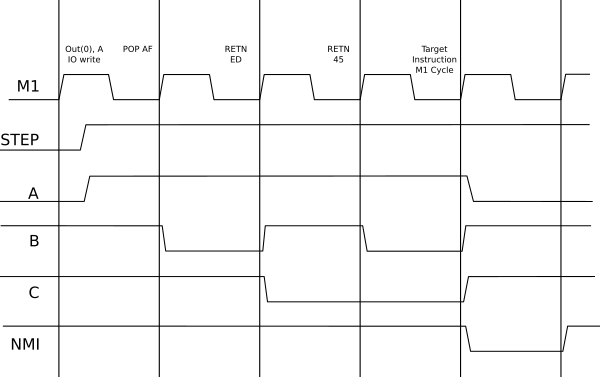

« Reply #31 on: July 28, 2013, 09:53:56 pm »
Something a little more fun - how to build a system with more than 64k of RAM1.
I built a couple of systems like this when I was younger - mid 80's I think. Partly to see if I could and partly with the intent to develop a multi-tasking OS. That bit never happened :) but the hardware worked.
I've lost the original circuit diagrams and haven't got either of the boards to hand so I'm not sure this is quite how I did it - in fact I know it isn't because the originals used DRAM but these days you can get 128k x 8 static rams which would make it easier to build. Of course the down side is that 74F189's are not that easy to come by any more. There are still a few listed on ebay so it wouldn't be totally impossible to construct.
You can get fast static RAM which you could use to do the mapping although everything I can find is total overkill - about the smallest 10ns SRAM I can see is 256kbit. Also the separate data in and data out of the 74F189 make the circuit a lot simpler to implement. A 74F89 can be substituted with output pull-up resistors. 74LS parts can probably be used for a 4MHz Z80 but the access time of the RAM eats into the address set-up time so for a Z80B you really need 74F series. A Z80H probably won't run like this unless you delay MREQ to allow some address set-up time and avoid glitches on the chip select outputs.
The circuit as it stands is a little incomplete - you need to provide an I/O address range selector to the active high enable of the first 74LS138.
The Z80 memory map is divided into 16 4k byte pages - each of these pages can be mapped onto one of 256 4k pages in a total memory space of 1M byte. This is done by using a small fast scratch pad RAM consisting of two 74F189 16x4bit RAM to make a 16x8 bit RAM.
The outputs of the RAM form an extended 20-bit address bus. The top three bits drive a 74LS138 which is used to produce chip selects for up to eight CY62128 8x 128kbyte SRAM chips. The bottom 5 bits of the 74F189 outputs are then combined with the first 12 address bits from the Z80 to form the 17 address lines needed to drive the CY62128's
The bottom 32k of the Z80 address space is switchable between ROM and RAM. Following reset the D-type flip flop is cleared which allows A15 low to select the 27C256 when MREQ is also active. At the same time the complementary output from the flip flop is high this is ANDed with the complement of A15 and the result used to drive one of the active low enables on the address decode 74LS138. Thus for addresses where A15 is low that 74LS138 is disabled and no SRAM chip will be selected. When A15 is high (addresses from 0x8000 to 0xFFFF) the 74LS138 enable pin will be driven low.
Once a "1" is written to the flip flop the high signal will block the 27C256 from being selected and the 74LS138 enable line will be low regardless of A15's state.
With the ROM switched in all 1M byte of the expanded address range can still be accessed but only if mapped into the top half of the Z80 address space.
To set up a mapping we make use of the fact that the "OUT (C), A" instruction is really "OUT (BC), A" so the top four bits of B should be the page in the Z80 address space we wish to map and the accumulator should be the complement of the expanded address range page we want (the complement because the 74F189 outputs are inverted).
Edit: Oh, yes, while I think of it - as far as I can see this scheme would work just fine for bank switched CP/M 3 with suitable BIOS code to achieve the bank switching as it's a much more flexible scheme than CP/M needs.
[1] Yes, I know, build a system which uses a processor that has a bigger address bus. At the time I wanted to build a 68000 based system but didn't have any form of OS to run on one and didn't fancy writing one. Also 68000's were a bit expensive.

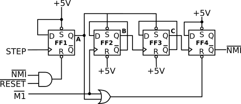

Advanced Z80 memory interfacing pt 2
« Reply #47 on: July 31, 2013, 10:33:35 pm »
I thought I'd finish my trip down memory lane with a look at interfacing dynamic RAM.
The systems that I built with large (i.e. > 64k) RAM had a DRAM interface for 2 banks of 256k x 1-bit DRAMs for up to 512k bytes of memory though I ended up with two systems which had 256k as I could only afford 16 DRAMs.
I confess here that this is not my original circuit - it's a fresh design based on a couple of things that I remember about the original - mostly that I only used a couple of flip-flops and I'm sure that I implemented CAS before RAS refresh to get around the fact that the Z80 only has a 7 bit refresh counter. It "feels about right" though :)
This does mean I can't guarantee that it would work if implemented. I don't view that as too much of a big deal though since I don't think I'd bother these days. At the time 8k x 8 was a huge SRAM so to get 512k would have taken 64 chips - just not practical and much more price-wise than 16 DRAMs. Since you can now get much larger SRAMs I don't think I would bother with the complexity for a small Z80 SBC
That said it's not all that complicated, what complexity there is comes from the fact that DRAMs have a multiplexed address bus and need to be periodically refreshed, fortunately the Z80 does some of the work for us by providing a refresh signal and a row counter for refresh addresses. Unfortunately anything bigger than a 16k DRAM tends to have more row address bits than the Z80 provides.

The first thing to look at is the timing diagram - the Z80 has two memory read patterns and one memory write. Of these the opcode fetch or M1 cycle has the tightest timing so most people design to that and the longer memory read/write cycles should then take care of themselves.
Here's the timing (mostly without taking gate delays into account).
One thing to notice is that RAS is just a copy of MREQ (that's handy!). Using RAS before CAS means that the multiplexing signal which drives the 74LS157 just needs to be copy of MREQ which is not active during a refresh cycle - easy to drive with a couple of gates (the slight delay this produces helps to ensure that the row address hold times should be easily met).
That just leaves CAS - this was generated in two halves. The first is a copy of MREQ which is delayed until the start of T2 (CASm on the diagrams). For a 4MHz Z80 MREQ is guaranteed to be not more than 85ns after the falling clock in T1 so that gives us about 40ns of RAS to CAS delay which should be OK.
The second part of the CAS signal is active during refresh - this is generated as a shortened version of the RFSH signal. In this case we start CAS with the falling edge of RFSH but deactivate it with the next rising clock edge. This is CASr on the diagrams.
The two signals are then combined with an AND gate,
Finally RAS is not quite an unmodified MREQ - we will probably want to supply an enable signal from the address decode logic, however we do not want this to interfere with RAS during the refresh cycle so we gate it with a select plus RFSH to generate the actual RAS circuit.
The circuit ends up looking like this.
EDIT: Looking at something else I chanced upon the fact that the above circuit is nothing to do with the memory interface - it is the Nascom 2 single step circuit. I obviously overwrote the old image my error. I'll try to restore the correct diagram.
I think it should work with most 64k x 4 DRAM chips. Clock to CAS should be about 40ns with LSTTL, for a 4MHz Z80 there's a 35ns data-in set-up time so the RAM needs a CAS access time of 250-(40+35) or 175ns, give-or-take. As even the venerable 4116-25 had a TCAC of 165ns I don't foresee any problems with anything faster. For a 6Mhz system the figure will be about 100ns which shoulkd be do-able with a "150ns" DRAM.
The only thing I can see that might be iffy is whether there's enough CAS precharge time for the refresh cycle. One problem is that there is no specification for the interval between MREQ going inactive and RFSH going active - however it's probably 40 or 50ns on a 4MHz part which should be enough, 6 or 8MHz parts might become marginal here. Wiser heads might spot other mistakes I made.
